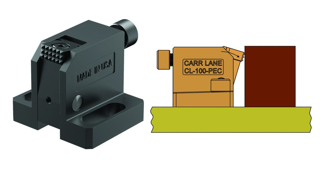

Carr Lane Manufacturing Co.'s pivoting edge clamp is well suited for holding large castings and other tall workpieces, and converts easily from manual to hydraulic operation, making it versatile and flexible. The pivoting jaw exerts clamping force forward and downward at the same time.
The jaw has a replaceable serrated gripper made of hardened tool steel for high-production durability. The slotted base provides adjustability and has a tapered top surface to prevent the clamp from moving.
