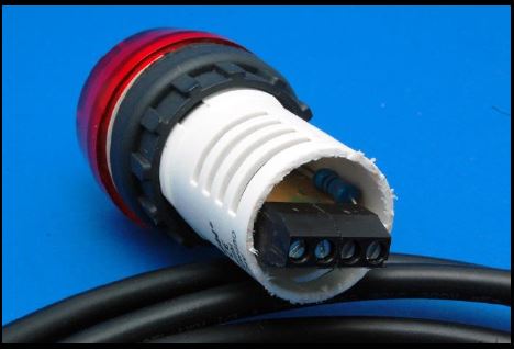

Transducers USA has announced the addition of a plastic warning indicator to its Tonelight series. This panel-mounted device is suitable for use as a warning indicator, which delivers both an audible and visual warning signal, especially helpful when a large amount of ambient noise is present.
The unique feature of the TRIP-LB200P Tonelight Model is the independent control of the two indicators. A PLC pulses the flashing LEDs and the beeping frequency of each circuit independently.

The TRIP-LB200P Tonelight model is IP50 rated. Beepers emit at >80 dB at 10 cm. Lens color options include red (standard); optional colors include green, yellow, orange, blue and white. These warning indicators utilize standard 22mm panel mounting (only one panel hole needed for both signals). The voltage operation for this model can include 6, 12, 24, 36 and 48VDC and 110 and 220VAC.
A new Tonelight is being offered that has four terminals that can be utilized to actuate the LED light and/or the audio alarm in separate modes, allowing a delay on either output. The unit has a four-position terminal block. Two terminals for the RED LED and 2 terminals for the audio alarm. With this type of actuation, either the LED or the alarm can be sequenced from an outside control circuit.
