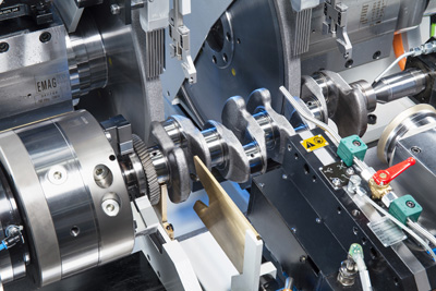

EMAG experts also develop tailor-made grinding solutions for shaft-type components. The new PMD 2 machine complements this crankshaft grinder know-how. It is designed for the machining of passenger car crankshafts and features twin grinding heads that allow the simultaneous grinding of two pin or main bearings in a single setup using two grinding wheels. Its capacity covers small components up to 500mm length.
“With this machine we are rounding out our range of crankshaft grinders to include the machining of smaller components,” explains Dr. Guido Hegener, Managing Director of EMAG Maschinenfabrik GmbH. “Up to now, our range of machines did not include a horizontal twin-head grinder for smaller crankshafts. This gap is now filled with the PMD 2, a machine with an excellent price-performance ratio ideally suited to combat the increasing competition in the automotive industry.”
Relying on their technologies that have proven successful in the market, the basis for the PMD 2 is the established “Series 2” from EMAG NAXOS-UNION and EMAG KOPP. These machines combine high-tech grinding technology with precision, great efficiency, process integrity and simple operation. This applies to the PMD 2 as well, where two CBN grinding wheels machine crankshafts to the highest precision. To achieve this, the machine is equipped with a direct-driven workspindle, hydrostatic guideways and a linear motor in the X-axis, as well as an in-process measuring control that allows for roundness monitoring and correction in the machine.
“The operator enters the relevant command in the control and the measuring process is carried out once the bearing has been ground. The software, developed by EMAG, then calculates the relevant correction values from the remaining roundness errors. This allows for the subsequent manufacturing processes to be successively optimized,” adds Hegener.
The technology also stands out with its simultaneous use of two grinding wheels. The twin-tool process opens up a number of possibilities for the user, depending on component and machining requirements. Two pin bearings or main and pin bearing are machined simultaneously, reducing cycle times. For instance, a four-cylinder crankshaft is machined in less than two minutes. The grinding wheels can, if required, be arranged very close together so that adjoining pin and main bearings can be machined simultaneously. Both grinding spindles and work headstock are direct-driven, further increasing precision and productivity levels. “We have strung together a technologically very interesting package,” states Hegener.
The machine also features a compact but flexible construction, for example the electrical cabinet is included in the enclosure. Connecting an automatic loading system poses no problem, and both emulsion and oil can be used as coolants.
“Flexibility was of great importance in using this technology,” confirms Hegener. “We tailor the machine exactly to the customer’s requirements. Integration into an existing, complex production line is an important option, but there is the option of the machine being used as a stand-alone solution with manual loading. We expect this approach will give users a competitive edge while component quality and production costs are gaining importance worldwide.”
