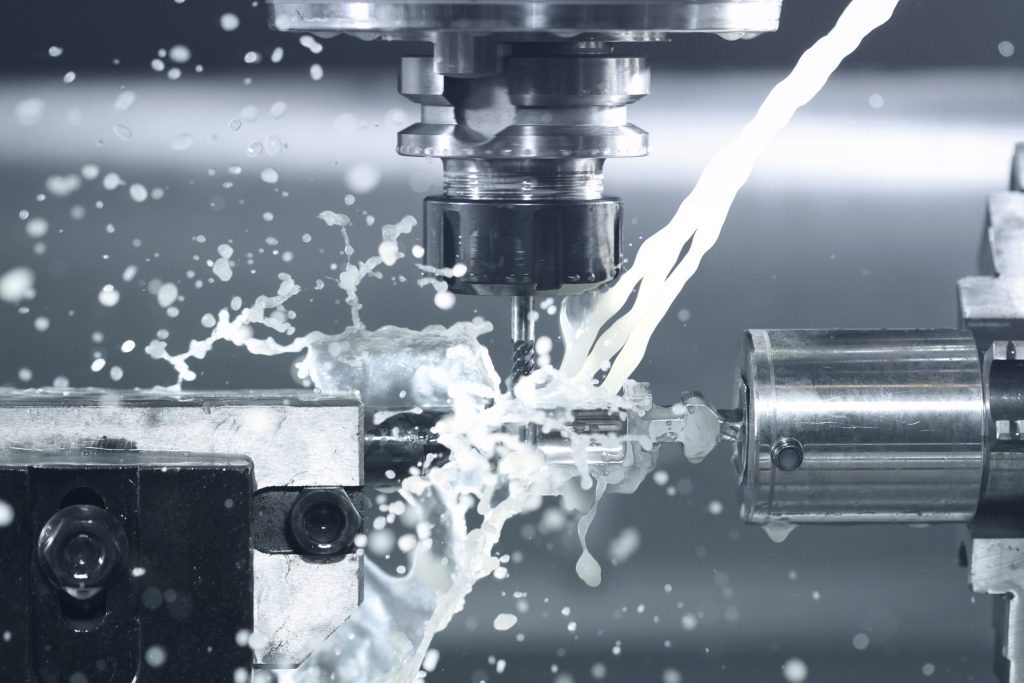

To support an automotive aluminum part milling specialist, CONDAT offered a solution to recurring dermatitis issues reported by several operators: POLYBIO 650 ABF oil. Thanks to its specific fully amine-free formulation and its low pH, POLYBIO 650 ABF considerably reduces skin irritations risk.
Furthermore, the absence of amines in the milling bath provides additional comfort of use to operators by limiting the spread of ammonia odours released by the growth of bacterial strains.
In the automotive industry, on leaving the aluminium foundry shop floors, rough parts are milled and the tapping, drilling and milling operations can be especially difficult. In this sector, end users routinely work with series 40000 alloys with silicon additives such as 42200 (AlSi7Mg), 43200 (AlSi10Mg) or 46500 (AlSi9Cu). The high silicon content alloys (up to 12 percent) can cause extensive abrasion wear to tools. In these conditions POLYBIO 650 ABF’s high lubricating power makes it possible to increase tool service life by 10 to 15 percent, depending on the application. Tapping and torque tests clearly illustrated the POLYBIO 650 ABF enhanced performance compared to many competitor products. The tapping and torque test are used to make a comparative study of the forces required for tapping by deformation or removal of filings under iso-conditions.
Machining these aluminium alloys generates microscratches on the parts and difficulties in keeping to exact measurements. The result is random roughness that only high lubrication can mitigate. POLYBIO 650 ABF’s lubricating power provides a solution to this problem by reducing roughness. This lubricating power significantly improves surface conditions: the parts are shinier and have a “mirror” effect.
During production, lubricant losses can be significant and top-ups made daily to keep the bath effective. These losses have several causes, in particular the lubricant adherence to the part, the filings, and the evaporation of the water. POLYBIO 650 ABF’s detergency and wettability make it possible to reduce the amount of oil on the parts and filings, thereby reducing lubrication consumption by a significant reduction in top-ups.
