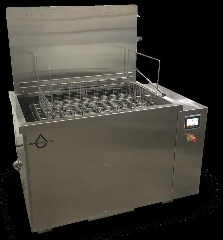

Omegasonics announced the introduction of the PowerLift 4560, a new unit specifically engineered to clean heavy parts because it allows the operator to lower and lift parts out of the tank with an assisted pneumatic lift. The 120-gallon PowerLift 4560 is a large-capacity ultrasonic cleaning system with 6000 watts of peak ultrasound.
October 3, 2016
In addition, the lift is available with an optional agitation feature controlled by an easy to use touchscreen. Agitation moves the basket up and down with a 3″ stroke to remove any loose dirt remaining in crevices after the ultrasonic process.
  • 4″ Weir
  • 3 phase/240 VAC/30 Amp
  • Tank Dimensions: 38″ length x 29″ width x 19″ depth (23″ overall)
  • Overall Dimensions: 53-1/2″ length x 38-1/2″ width x 34-1/2″ height to tank front lip
“The PowerLift 4560 is an ideal ultrasonic cleaning tool for clients using it to clean large heavy items such as transmission cases, large castings and molds, large food processing applications and heat exchangers,” said Frank Pedeflous, president of Omegasonics. “We designed this unit with the piston outside of the bath for increased space utilization to save our clients on wasted cleaning detergent costs.”
