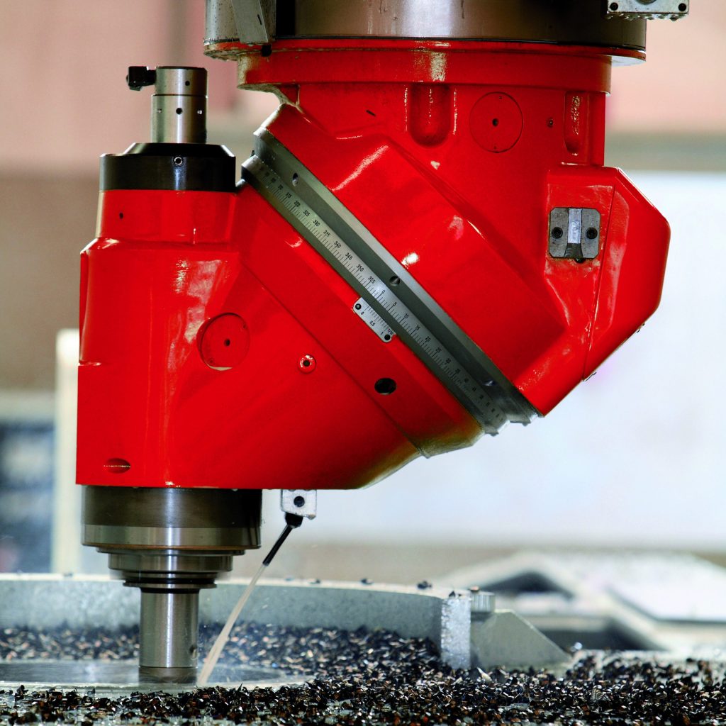

The mechanical universal milling head provides 6000 rpm, 38 kW (S1), 1000 Nm (S1), or users can choose a milling head with a straight head or with high-Speed motorized spindles, or indexed or full 5-axis contouring milling heads, to suite the material being machined and the geometric shape.
