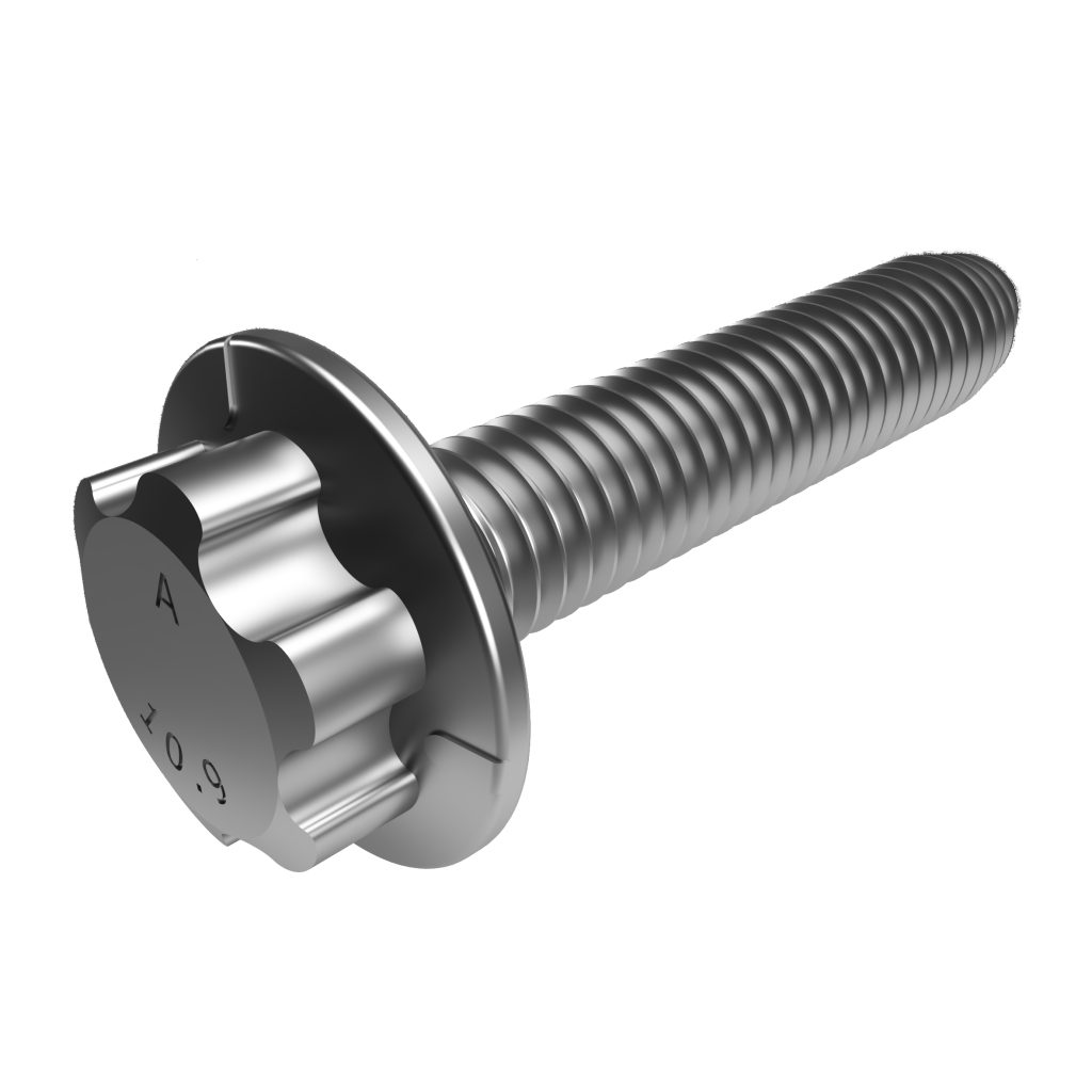

Powertite, with its perfect geometric fit, increases load-bearing capacity in the tapped nut thread by over 20 percent compared to screws with trilobular load-bearing cross-section. That creates a series of technical and commercial benefits: standards-compliant tapping torques, plastically stressed assembly even into conical cast core holes in Al-Gd, a preload force similar to metric fastenings, and the possibility of larger core hole tolerances to optimise lightweight metals casting.

It is precisely for such applications that Arnold Umformtechnik GmbH & Co. KG has developed Powertite. – a round thread-tapping screw with a trilobular tapping zone. This means that at the deformation point the screw has a slightly triangular cross-section (rounded edges) to reduce the tapping torque. The length of the tapping zone at 3 x p (p=thread pitch) is optimised for the installation space, allowing the forming energy created by the thread-tapping process to be distributed over several thread turns and giving optimal setting and centring of the screw. The round load-bearing cross-section has a defined overlap, the external diameter of the screw is always greater than the nominal diameter. This ensures a greater overlap of the screw’s thread edges and tapped nut thread. The combination of the trilobular shape in the tapping zone and the round cross-section in the load-bearing section achieves a significant improvement in thread-tapping screw fastenings. This is because firstly, the tapping torques are low and secondly, because the load capacity of the tapped nut thread is considerably greater.

According to Arnold Umformtechnik, Powertite, with its perfect geometric fit, increases load-bearing capacity in the tapped nut thread by over 20 percent compared to screws with trilobular load-bearing cross-section. That creates a series of technical and commercial benefits: standards-compliant tapping torques, plastically stressed assembly even into conical cast core holes in Al-Gd, a preload force similar to metric fastenings, and the possibility of larger core hole tolerances to optimise lightweight metals casting. As well, assembly reliability is very good, and it can also be used in steel, aluminium and other lightweight metals. Furthermore, it is possible to make the screw fastening repeatedly and they can be replaced by metric screws if needed for servicing.
