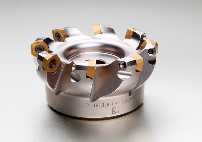

The latest positive axial rake, high-feed cutter from Dormer Pramet allows it to be applied with multiple materials across various applications. The Pramet Penta HF is an aggressive high-feed cutter suitable for machining a variety of materials, including heat-treated and difficult-to-machine steels, stainless steels and heat-resistant superalloys (HRSA).
March 23, 2016
“Productivity starts at the cutting edge of the tool,” Russ Reinhart, U.S. national sales manager, explains. “Utilizing the Penta HF High Feed milling and PDMW inserts we reduced the total cycle time by 20 minutes in a structural steel application. Our milling cutter was able to complete the operation with only one cutting edge, thus eliminating machine stoppage to index the inserts while our competition required the operator to index inserts a total three times per component.”
Features of the Penta HF and accompanying insert range include:
Internal coolant on body for deep cavity milling/helical applications
19° lead with positive axial inclination requiring less horsepower
Extensive insert/grade program for most materials/applications
Economical five cutting edge inserts
Special surface finish for increased corrosion resistance, reduced wear and lower friction resistance
Polished inserts for high feed and differential pitch
The Penta HF is a suitable option for lower-horsepower applications with the versatility of faster feeds and multiple-material application.
