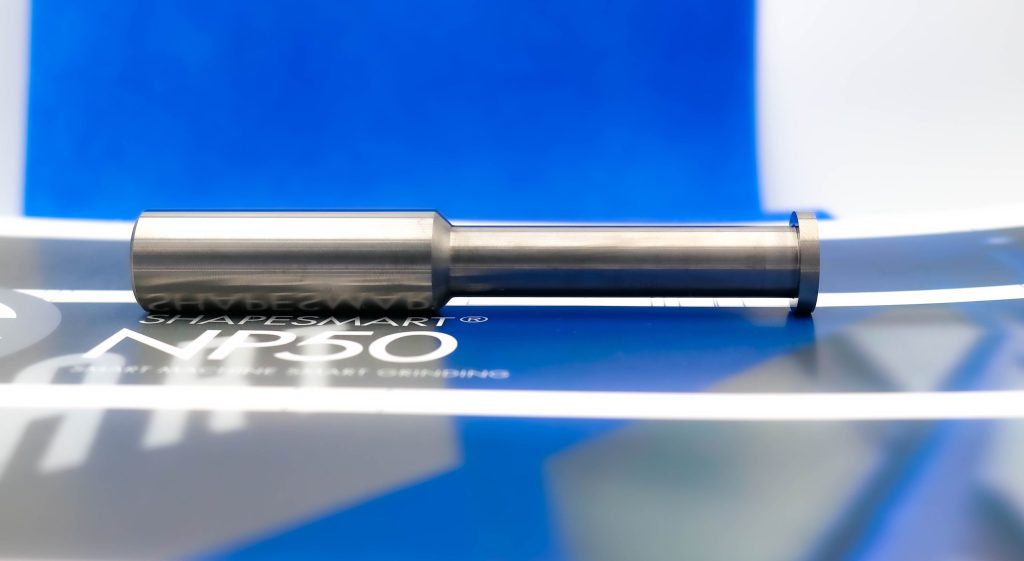

Rollomatic developed an advanced process known as “double rough pinch grinding” which vastly decreases cycle times for blank preparation of the following carbide cutting tools:
  • T‐slot cutters
  • Thread endmills
  • Rotary burs
  • Endmills for die and mold machining
  • Long‐reach endmills
  • Repeatable process for long‐batch production.
  • Both grinding stations are equipped with diamond wheels with a grit size which is normally used for rough grinding.
  • The blank is then “pinched” between two rough‐grit diamond wheels.
  • The wheels interact on the blank simultaneously in a synchronized approach. While one wheel does the majority of the work, the second wheel cleans up what was left from the other wheel.
  • The surface finish on the blank is better than what would normally be considered an acceptable finish.
  • The cycle time is a fraction of what it would have been using the customary pinch grinding method with roughing and finishing wheels.

On a test production run of 100 pieces, the following results were achieved:
  • Cycle time without loading/unloading was 5 min. and 5 sec.
  • Wheel spindle load on the roughing side (synchronous spindle) was no more than 35%. The limiting factor is the wheel wear and not the machine. The machine will always outperform the wheels.
  • The highly efficient synchronous spindles, running at 35% power draw or less, do not release any heat into the machine or into the grinding process. This greatly improves the thermal stability of the machine.
  • Synchronous spindles operate much quieter even under load compared to induction motors.
  • An excellent G‐ratio was achieved which is the ratio between the stock removal and the wheel wear volume.
  • The wheel wear was manageable. With the clean‐up pass of the 2nd wheel, the dimensional tolerances of the blank were easily maintained.
  • There were no TIR issues and surface finish was above expectations.
  • This process outperforms alternative competitive equipment by more than 50%.
