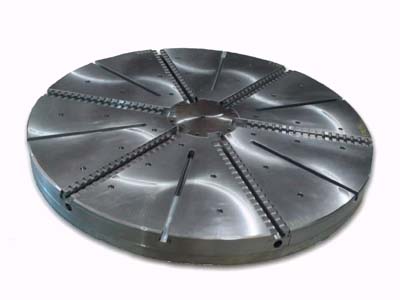

Planet Products introduces its ProHold Series of lightweight, low profile self centering chucks for vertical turning lathes (VTL) up to 66" in diameter.
November 13, 2012
Planet Products introduces its ProHold Series of lightweight, low profile self centering chucks for vertical turning lathes (VTL) up to 66″ in diameter. The proprietary clamping system allows the chucks to built with a low profile to increase the available machining envelope. The lighter weight allows greater table capacity for larger workpieces, and reduced rotational inertia.
Options include steel or aluminum construction, individual micro-adjustable jaws, T-slots, and modular top tooling. Available in mechanical or hydraulic clamping, with 2-, 3-, 4- or 6-jaw configurations for all popular VTL models.
