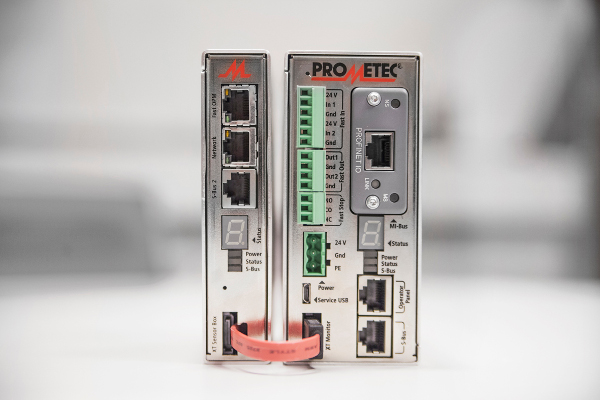

PROMOS 3+, a refinement of the proven and tested PROMOS 2 system, offers even more process safety for machining processes. As a monitoring system, it ensures that the right tool is in place and that the process is completed within defined parameters.
“PROMOS 3+ stops the machine if the tool is missing, breaks or collides with the workpiece,” explains Dr. Klaus Kristoffel, managing director of Prometec. “If the work process veers from predefined parameters, this is corrected by the system. In addition, PROMOS 3+ is tailored to user needs and provides warning of impending tool wear or breakage.”
The PROMOS 3+ monitoring system is in continuous communication with the machine. It gets its signals either directly from the machine’s digital drive data or from sensors that monitor parameters such as force, structure-borne noise, or active power against limit values. The system’s advantages include improved process safety, longer tool life, and assured component quality. Furthermore, less tool breakage is likely to occur, along with less damage in the event of a collision. As a result of these benefits, machine shops will also find that downtime is minimized, while the potential for unmanned machining increases.
Thanks to PROMETEC’s compact monitor, intelligent vibration sensor and cost-effective control element, an economical collision detector has been created that can be scaled into a comprehensive multi-level, multi-channel monitoring solution. Further benefits of the modular PROMOS 3+ include complete independence of specific control types, compact hardware modules that demand little space in switchgear cabinets (all connections and displays are on the front), quick and easy installation and setup, and very little training required due to automated functions for adaptation to customer systems.
