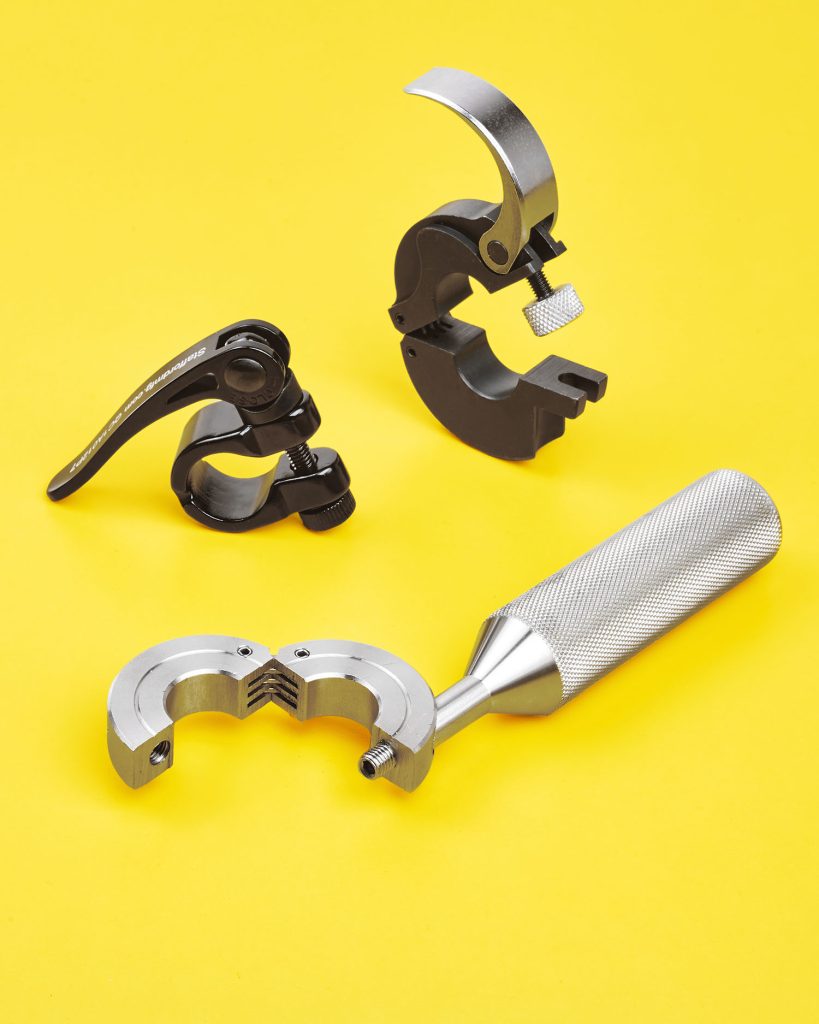

Stafford quick-release clamp collars come in three designs that provide easy attachment and fully adjustable clamping by hand without tools. Featuring an integral hinge with a conformal cam lever and a knurled screw, the Staff-Lok shaft collar has a mounting flat with a countersunk drilled and tapped hole and two mounting holes on the face. The Flip-Lok clamp collar has a cam lever for clamping and a knurled nut to create a preset.
The third design alternative is the Grip & Go quick-release handle, which can convert any standard shaft collar into a rapidly adjustable locating device and comes in steel, stainless steel and aluminum in two sizes. The Staff-Lok is made from steel in 0.5″ to 2.5″ ID sizes, and the Flip-Lok is made from hard-coat black anodized aluminum with steel fasteners and comes in five ID sizes from 0.75″ to 1.5″.
