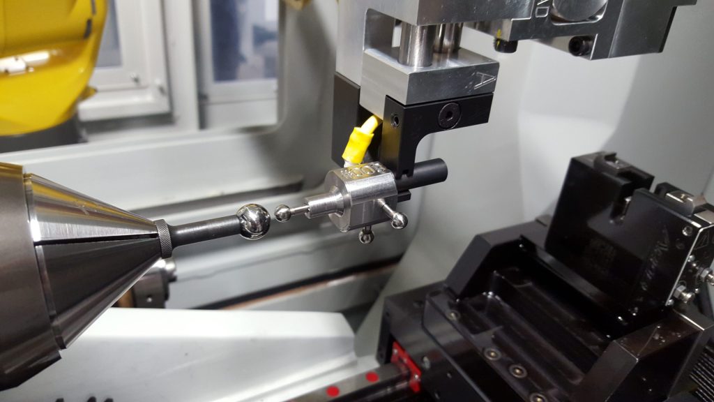

RoboTeach is a machine-run program that uses the high accuracy of the grinding machine to measure the robot position and automatically teach and calibrate robot positioning. The teaching process uses an electrical contact touch probe held in the robot gripper and a mandrel that locates the position of the machine collet adaptor and tool storage pallets.
A series of instructions on the operator screen guide the user on how to teach the FANUC robot using ANCA Loadermate software. The easy-to-follow instructions ensure the operator can quickly and easily teach the robot positions and coordinates.
The RoboTeach product has a software option and teach tooling kit. The teach tooling kit is supplied in a compact carry case with relevant teaching materials.
