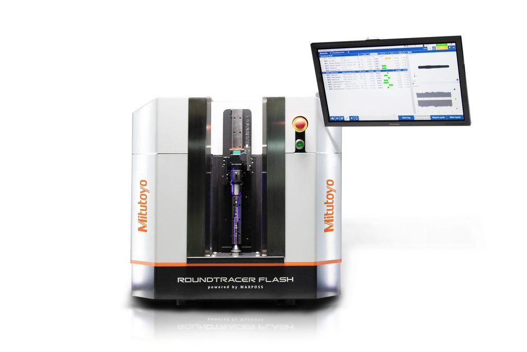

Based on side-by-side two-dimensional image architecture, this allows images acquired by different sensors to be perfectly combined to generate a single workpiece image containing no defects or gaps at stitching edges.Measures parts up to 300mm in length without any vertical movement of the sensors or part. Executes 100 static measurements in two seconds regardless of how the measurement sections are distributed along the workpiece.
Mitutoyo America Corporation is pleased to announce the release of the new Roundtracer Flash. This non-contact measuring unit is expected to deliver even more speed and versatility to the Mitutoyo Form Measurement line.
Features include:
- Based on side-by-side two-dimensional image architecture, this allows images acquired by different sensors to be perfectly combined to generate a single workpiece image containing no defects or gaps at stitching edges
- Measures parts up to 300mm in length without any vertical movement of the sensors or part
- Executes 100 static measurements in two seconds regardless of how the measurement sections are distributed along the workpiece
- With no Z-axis movement to capture 2D images, consistency of profiles and part geometries remain stable for millions of cycles thus minimizing maintenance intervals
- Performs measurements with one single button operation
- Easy to implement into a smart factory when using an external robot system to automate workpiece loading
- 7 available USB ports data output and code reading
