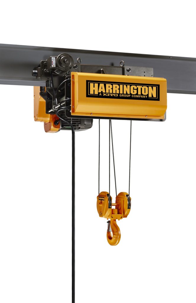

Harrington Hoists Inc. has introduced its new RY series electric wire rope hoists. Designed for safety, reliability and performance, these ultralow headroom trolley hoists have an H4 duty rating for high demand applications and standard configurations are certified and listed to UL 1340 "Standard for Hoists" and CSA 22.2 No. 33.
May 20, 2019
Harrington Hoists Inc. has introduced its new RY series electric wire rope hoists. Designed for safety, reliability and performance, these ultralow headroom trolley hoists have an H4 duty rating for high demand applications and standard configurations are certified and listed to UL 1340 “Standard for Hoists” and CSA 22.2 No. 33.
These hoists come standard with dual-speed variable-frequency drive (VFD) control on both hoist and trolley for optimal speed adjustability. Also standard is a no-load high-speed function that allows hoist operation at 1.5 times the standard high speed with a load less than 25% of rated capacity.
Additional features include: premium IWRC wire rope, a full 360° rope guide, a high-performance Pull-Rotor motor brake with a 5-year warranty and an externally adjustable upper/lower limit switch to easily set the desired range of operation. They are available in 3- and 5-ton capacities in voltages of (208-230)-3-50/60 or (415-460)-3-50/60.
