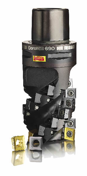

Sandvik Coromant Co. offers two new insert grades for milling titanium: S30T and S40T. S30T has a PVD coating on a micrograin carbide substrate so sharp edges resist fatigue and microchipping, according to the company. S40T features a CVD coating on a cemented carbide substrate with high toughness to withstand vibration and difficult cutting conditions. CoroMill cutters for plunging, profiling, slot milling, facemilling and shoulder milling accept the inserts.
