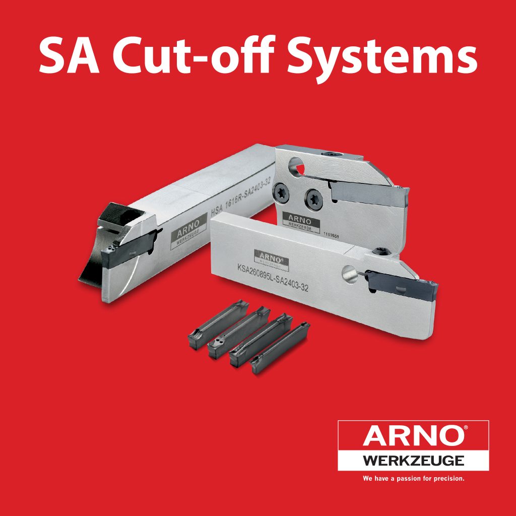

ARNO Werkzeuge USA announced the introduction of its SA series of cutting tools and inserts for grooving and part-off or cut-off operations for North America. The SA system from Arno USA is a modular grooving system with a single toolholder, which turns into different tool variants by simply changing the support blade and clamp. Enabling combined operations with just one tool, ARNO grooving systems offer chip removal in all three main cutting directions. The SA range also features precision-ground two- or three-edged cutting inserts in various designs, different shapes and types, which gives the best cutting performance, speed and efficiency, according to the company.
The SA range of cutting tools and inserts from ARNO USA specializes in parting-off or cut-off operation in machining, metalworking and plastics applications. The series comes in three unique systems to accommodate the requirements of various machining operations and customers in aerospace, plastics and medical industries.
The SA series includes a monoblock, modular and blade style system. It is a cost-effective solution for radial grooving as well as parting-off up to 5.512" (140mm) in diameter. The SA monoblock holder is used with a wide range of double-sided inserts including the Arno SA16, SA17, SA24, SA35 und SA40 in .059" (1.5mm), .079" (2mm), .118" (3mm), .157" (4mm), .197" (5mm), .236" (6mm), .315 " (8mm) und .394" (10mm) widths.
Martin Gardner, president of ARNO Werkzeuge USA, adds, “Now with the new SA family from ARNO USA, customers can choose from and utilize an extensive range of cost-effective, cut-off or part-off cutting tools and inserts for demanding metal cutting and plastics applications in machine shop operations.”
ARNO’s family of SA range cutting tools and inserts for grooving and parting-off or cut-off operations include:
Monoblock holders
• Shank sizes from .312“ to 1.500“ (8 ‒ 40mm)
• Groove widths from .059“ to .394“ (1.5 to 10mm)
• ACS (Arno Coolant System) holders available
Blades
• Sizes 1.024“ (26mm) and 1.260“ (32mm)
• Groove widths from .059“ to .157“ (1.5 to 4mm)
• ACS blades available (ACS1 and ACS2)
Modules
• Grooving depth of cut .393“ to 2.756“ (10.0 to 70.0mm)
• ACS modules available (ACS1 and ACS2)
