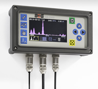

The SB-2000 is a compact manual balancing system that offers both one- and two-plane manual balancing capabilities. It can be used with all of SBS's existing keypad control-based mounting hardware and includes a dedicated CNC/PLC interface, so that the machine can be alerted when the vibration exceeds the user specified limits so that personnel may intervene to rebalance the machine.
Where the two products differ is in their packaging. The SB-2000 is designed as a unit to be permanently installed on the machine. With its digital design and intuitive icon-driven user interface, the SB-2000 is simple to set up and easy to use. Five balancing modes are supported (single position, two-weight, three-weight, fixed position and circumferential arc) with storage capacity for up to 30 balancing profiles for different machines or setups. The unit also allows spectrum vibration plots to be generated and stored.
The SB-2000-P is designed with portability in mind. The CNC/PLC interface is removed and a magnetic attachment system is provided, such that the user can easily attach it to any metal surface for balancing, then remove it and carry it to the next machine. The USB port allows the user to export balance data and settings and to update unit firmware. The SB-2000-P is available in a travel case that includes the vibration sensors and rpm sensor, along with other accessories that assist when using it in a mobile fashion.
