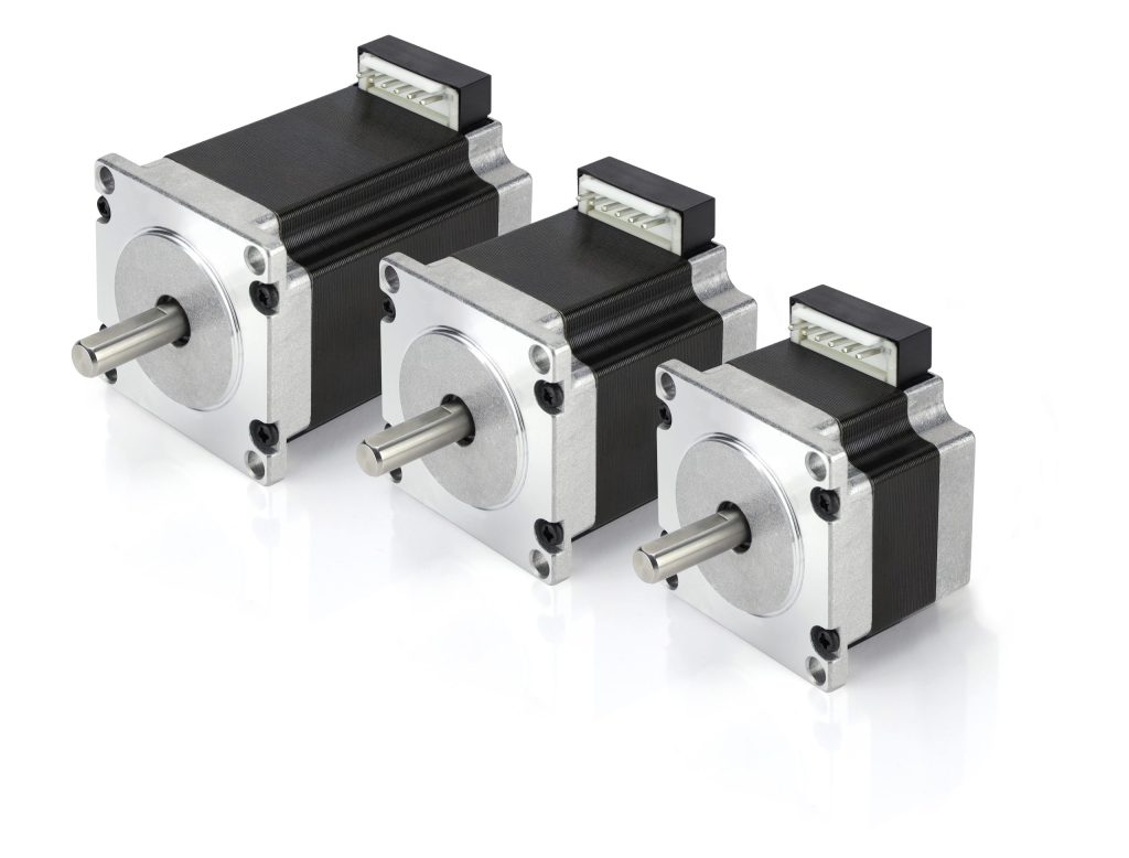

With the SCA5618, Nanotec offers a stepper motor with 15-30% more torque than comparable motors with a 56 mm flange (NEMA 23). Thanks to an improved stator geometry and optimized magnetic materials, the rotor inertia is no higher than that of the predecessor model.
June 25, 2019
The SCA5618 is available in three lengths and with two different windings. Depending on length, the holding torque of this stepper motor is 0.6 to 2.3 Ncm; it has a resolution of 1.8°. For a higher resolution, the SCA5618 can also be combined with an optical or magnetic encoder. The integrated connector makes it easy to connect customized cables or replace an existing motor.
The new high-torque stepper motor from Nanotec can be ordered with an 8 mm D shaft or with a round 6.35 mm shaft. If more torque is required, the newly developed GP56 high-torque planetary gearboxes from Nanotec will be a perfect match for this stepper motor
