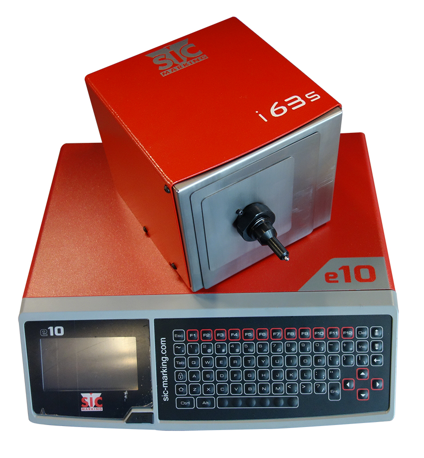

To complete its scribing range SIC Marking launches a new i63s marking machine. This new scribing marking head complements the i113s machine dedicated to deep marking on steel and other hard materials. i63s marking system has a compact yet robust design engineered for integration on production lines of all types of industrial environments. The marking quality is excellent with perfect continuous lines and very fast for materials of all kind, from plastic to hardened steel (up to 62 HRC).
The mechanical system is much simpler which has for consequence reduced maintenance. Already equipped with full connectivity (digital I/O, Ethernet TCP/IP, RS232…), the i63s scribing systems also offer many features to interact with all the elements that set up their environment. The machines can be easily integrated on all production lines using Profinet, Profibus and Ethernet/IP.
