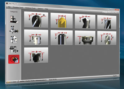

The solution incorporates software applications such as SpeedScan, which allows users to measure standard tools automatically without any data input, and AAIM (Automated Analysis Inspection and Measurement) which enables advanced users to make special tools that cut multiple features at the same time. Process, Automate, Connect technology also boasts the ability to work with MTConnect compliant machinery, providing users the ability to dynamically connect and communicate with as many devices and applications as possible.
