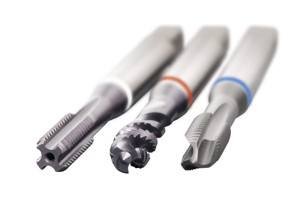

An end user in Cincinnati, machining small spindles of 303 stainless steel was achieving tool life of around 400 holes per tap. The Dormer spiral flute Blue Shark was tested as an alternative option. Although the recommended speed for this tap is 400 rpm, the end user ran their existing program (100 rpm) and achieved 1,500 holes. The company quickly switched to Shark taps and are looking to increase speed rate further to save time and improve tool life on other applications.
In Indianapolis, a machine shop bought a new CNC but was not happy with the performance or price of the tooling provided with it. The Dormer Yellow Shark tap was tested due to the soft steel material being machined, with the DIN version providing a suitable fixing option. Overall it achieved 50 percent more holes without changing running parameters and was less expensive than the previous tooling, making it a win-win. The shop now regularly purchases the Dormer range of Shark Line taps.
Over in Michigan, a company was tapping holes in a variety of stainless steels for items in the food industry. The company was having significant trouble with its taps, with many breaking, leading to the machined parts being scrapped. Dormer’s Blue Shark tap was brought in and now the customer is seeing none of its tooling break. It means the company is saving thousands of dollars by not scrapping taps or machined parts on a regular basis. All its taps are now from the Shark Line range and the shop is adding the Dormer Force drills, also specifically designed for stainless steels.
Finally, back in Ohio, a job shop specializing in precision machining was looking for a new tap to take over all its threading applications. The shop was looking for a “do all” tap to provide versatility across steels and stainless steel. Not getting enough tool life out of its current taps, the end user decided to put the Dormer Blue Shark through testing. The tap proved itself in all the applications, and the shop has converted all threading tools to Dormer Pramet.
Each Shark Line tap features a color ring on the tool shank denoting material suitability, promoting quick and easy tool selection. Yellow Shark is for threading low alloy steels, Red Shark for thread production in alloy steels, a stainless steel thread is achieved with Blue Shark, the White Shark is specifically for cast iron and other short chipping materials, while the Green Shark is for nonferrous materials.
