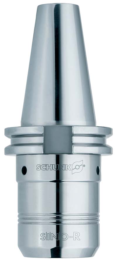

The new SINO-R from Schunk Inc. is a maintenance free toolholder especially well suited for rough milling.
March 1, 2010
The universal toolholder is based on an expansion technology system with a solid body as a pressure medium quickly clamping the cutting tool by using a simple actuation wrench. This simple operation saves unproductive machine down-time.
The excellent interaction of high radial rigidity and great dampening characteristics are special features that increase the smooth running of the tool. The result is a high tool life and increased material removal rates.
An additional plus for the user: the toolholder is flexible thanks to the use of intermediate sleeves. Nearly all common tool shank diameters can be clamped.
SINO-R holds your tool securely, with a maximum torque transmission (850 Nm (627 Ft-lb)), at a clamping diameter of 32mm (1.25″). It is precision-balanced standard to G 6.3 at 15000 rpm.
