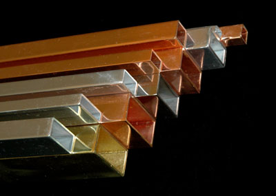

One example of a good candidate for this cupping technique is Kovar, used in many applications where thermal expansion rates are critical. Kovar is used in the electronics industry as a glass to metal sealing alloy for keeping electronic components hermetically sealed. Widely used as tubing in which to run fiber optics, Kovar is extremely expensive (about $30 a pound), so using a machine shop to hollow out the tube wastes a tremendous amount of the costly alloy. This makes the alternative method particularly attractive.
Other examples of applications that have taken advantage of the small quantity/high mix model include nickel tubes used in X-ray imaging technology, tubes used for oil drills, incubators, double wall tubing for high pressure testing, rectangular nickel tubes used for battery cans, as well as Invar and stainless tubing used in cryogenics equipment.
