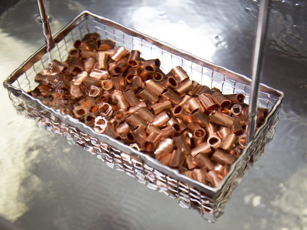

From “vapor only” to immersion, ultrasonics and turbulation, these innovative formulations meet or exceed almost any process requirements in place, according to the company. KYZEN’s in-house application labs in the United States and around the world help process engineers by verifying “live manufacturing” results for specific parts, materials, soils and process prior to any product commitment. This also ensures that manufacturers can meet their quality standards with required environmental compliance, worker safety and superior technical support.
KYZEN solvents consistently deliver desirable cleaning performance on a range of soils including oils, greases, waxes and other fluids. The combined features of low surface tension, non-flammability and superior solvency maximize cleaning strength. Designed to replace AK225, nPB, TCE and other undesirable solvents, KYZEN’s chemistries include:
  • Metalnox M6920–Classified as a non-VOC chemistry, M6920 is non-flammable and has ultralow MRI and global warming potential of 1. The chemistry is compatible with stainless steel, copper, iron and aluminum with or without excess water, and has excellent degreasing qualities for most lubes/oils. With PEL limits of 800 ppm, M6920 is a great choice for metals, plastics and elastomers as an effective and safe solvent.
  • Metalnox M6922 – A VOC compliant, M6922 effectively solubilizes ionic contaminants in hydrocarbon-based oils, water soluble soils and electronic fluxes. M6922 also has excellent degreasing qualities for most lubes and oils and a superior solvency for silicone fluids. With ultra-low Global Warming Potential of 1 and low surface tension rating of 12.7 dyne/cm (wettability), M6922 is a great choice to replace harsh chemistries while providing a safe and effective solvency.
  • Metalnox M6900 – Is a non-flammable chemistry used in immersion processes or “vapor” only process. M6900 has a low Global Warming Potential and PEL limits of 220 ppm. This chemistry helps conserve energy due to low operating temperature. It is effective in most metals and has excellent degreasing capabilities.
