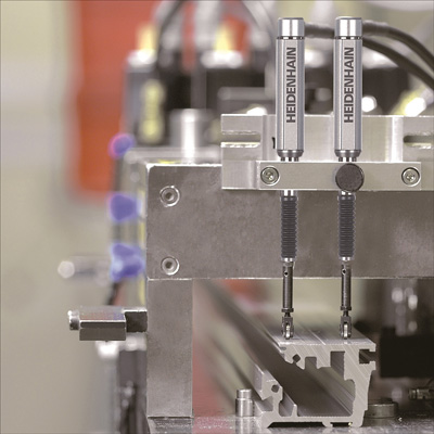

Specifically, HEIDENHAIN’s pencil probe-style SPECTO length gage series now offers versions with an improved force specification. Two new 1Vpp, 12mm stroke length variants of the SPECTO series are available for lower force applications. One is a variant with a weak spring, 0.4N of gaging force, and the other, without spring, applies 0.2N of force over the entire measuring length.
Additionally, both the 12mm stroke SPECTO and ACANTO series length gages offer an accompanying IP67 version enabling them to function in even the dirtiest shop environments.
