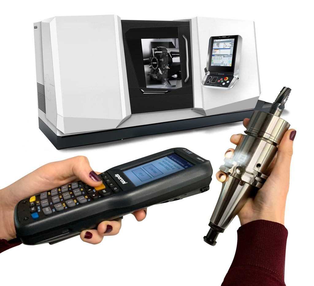

As opposed to measuring, printing a label and punching the data into the control, SPI prints a tool label with a QR code at the presetter that's then read by the SPI module at the machine control. The system can also be configured to send measurements directly into the tool NC's offset table.

As opposed to measuring, printing a label and punching the data into the control, SPI prints a tool label with a QR code at the presetter that’s then read by the SPI module at the machine control. The system can also be configured to send measurements directly into the tool NC’s offset table.
