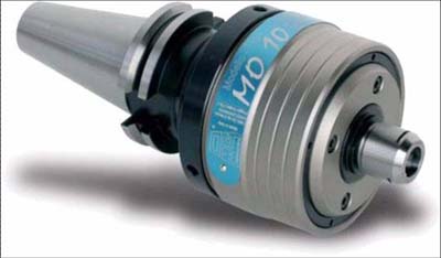

O.M.G. North America has introduced a new Spindle Speeder, adaptable to all CNC Machining Centers, for finish milling, drilling or engraving operations.
June 12, 2012
O.M.G. North America has introduced a new Spindle Speeder, adaptable to all CNC Machining Centers, for finish milling, drilling or engraving operations. The high output speed, of up to 35,000 RPM, allows you to get the ultimate performance from your cutting tools, especially when using carbide tools. Internal coolant through the spindle of up to 70 bar pressure is included.
O.M.G. Spindle Speeders are all made with ground gears guaranteeing high power transmission ratings and amazingly low noise. The spindle is supported by preloaded precision ball bearings with oblique contact for greater strength and concentricity within 0.01mm (.0004″).
