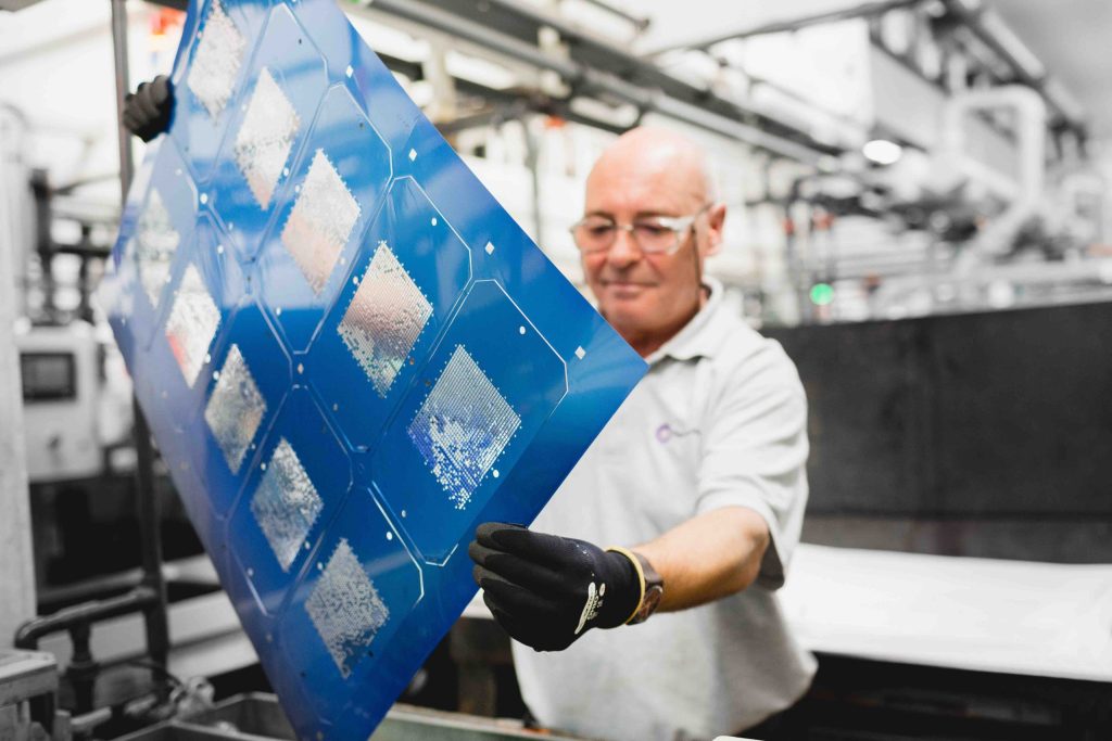

Chemical etching produces precision components by selectively removing metal through a photo-resist mask.
When compared with conventional sheet metalworking, it has a number of inherent advantages, key among which are its ability to produce parts without degrading material properties—no force or heat is used during processing—and almost limitless part complexity as component features are removed simultaneously using etchant chemistries.

Unlike conventional machining technologies, chemical etching offers greater levels of complexity when producing thin, precision steel meshes, filters and sieves.
With metal removed simultaneously when etched, multiple aperture geometries can be incorporated without incurring high tool or processing costs, and where punch-perforated sheets are prone to distortion, photo-etched mesh is burr- and stress-free with zero material degradation.
