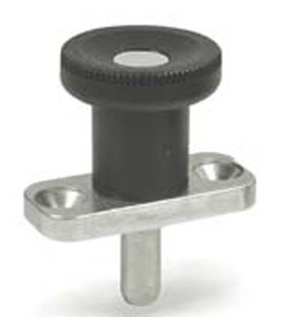

J.W. Winco Inc. announced it offers series GN 608.5 Stainless Steel Indexing Plungers with Plate Mount, non lock-out type, in metric sizes.
October 1, 2011
J.W. Winco Inc. announced it offers series GN 608.5 Stainless Steel Indexing Plungers with Plate Mount, non lock-out type, in metric sizes. The type of indexing plunger is used in applications that require surface mounting. Types with tapped hole or with threaded stud are offered. This series has been expanded with additional plunger pin lengths to widen the application opportunities. Please note that for these longer pins lengths (14 and 18mm), the pin does not fully retract. Plunger pin is made of stainless steel, chemically nickel-plated. Mounting plate is stainless steel. Knob is fabricated from matte black glass fiber reinforced nylon plastic, not removable. These plungers are RoHS compliant.
