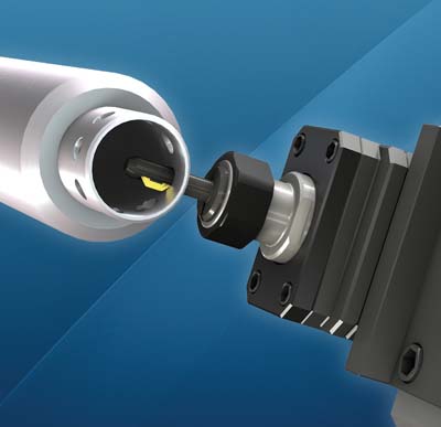

E-Z Burr Tool Co.'s Stubby series tools deburr the front and back of holes in a single pass and are available in HSS and carbide versions.
December 13, 2012
E-Z Burr Tool Co.'s Stubby series tools deburr the front and back of holes in a single pass and are available in HSS and carbide versions. The HSS tools are for hole diameters from 0.093" (2.38mm) through 0.236" (6mm). The carbide tools are for diameters from 0.125" (3.18mm) through 0.236" (6mm).
The overall length of the tools is 2.82" (71.6mm). Only 1.25" of the tool extends out of the collet. This prevents interference with the workpiece when space is limited, such as in a Swiss-style machine.
