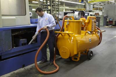

Sump Cleaner: This durable unit, available with single or twin compartments, ranges in capacity from 65 gallons (246 liters) to 1,000 gallons (3,780 liters). Push around, tow around or truck-mounted units are available. This Eriez Sump Cleaner removes the coolant, sludge and chips from the sump, filters the sludge and chips from the coolant, and returns the filtered coolant to the sump, or transports the coolant to waste treatment or to another Eriez Recycling System. A polypropylene filter sleeve filters to a nominal 50µm. For finer filtration, a single-use paper filter sleeve (to 20µm nominal) can be inserted into the chip basket.
The Sump Cleaner filters coolants rapidly and completely. In 10 minutes, a cylindrical grinder sump with 120 gallons (454 liters) of coolant and 700 pounds (317 kilograms) of sludge can be fully cleaned, coolant filtered and returned to the sump. Single Compartment Sump Cleaner: This 50 gallon (190 liter), 120-volt single compartment unit makes an excellent addition to the smaller shop where floor space is at a premium and space around machine tools is limited. This push-around unit, which incorporates many of the same features and functions as the larger Eriez Sump Cleaner, has a suction rate up to 85 gallons per minute (320 liters per minute) and a discharge rate of up to 40 gallons per minute (150 liters per minute).
Push Sump Cleaner: This mobile unit is available with a single 275-gallon (1,000 liter) compartment or twin compartments of 100 gallons (380 liters) each. The push sump cleaner features center-mounted, high-impact ball bearing wheels for good maneuverability and low rolling resistance.
Truck Sump Cleaner: An Eriez Sump Cleaner can be assembled on an LP or electric industrial truck for added mobility within a plant. The single compartment unit can process up to 400 gallons (1,500 liters), while the twin compartment model can filter up to 200 gallons (750 liters) each.
