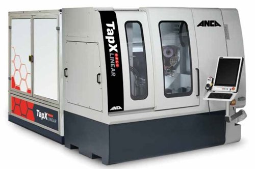

ANCA has delivered to market a single setup machine for complete tap manufacture. Continuing this tradition of industry firsts, ANCA offers the TapX Linear range of machines – a single setup tap grinding machine with LinX linear motor technology on X, Y and Z axis.
The rigid bisymmetrical column design on the solid polymer concrete base has been the foundation design of ANCA machines over the years. Now, in addition, ANCA’s new LinX cylindrical linear motors and linear glass scales are fitted as standard on X, Y and Z axis for proven and unsurpassed long term reliability and accuracy.
The result is a machine that ensures customers will meet ever increasing market demands of precision tap grinding. TapX machines are purpose-built, with tooling, coolant delivery and automation specifically for production grinding of all types of taps, from M3 up to M50, whether in high speed steel or carbide.
Clever tooling design means change over from one tap type to another can be done in minutes, not hours. This delivers greater flexibility in your tap production and results in increased productivity and reduced costs.
