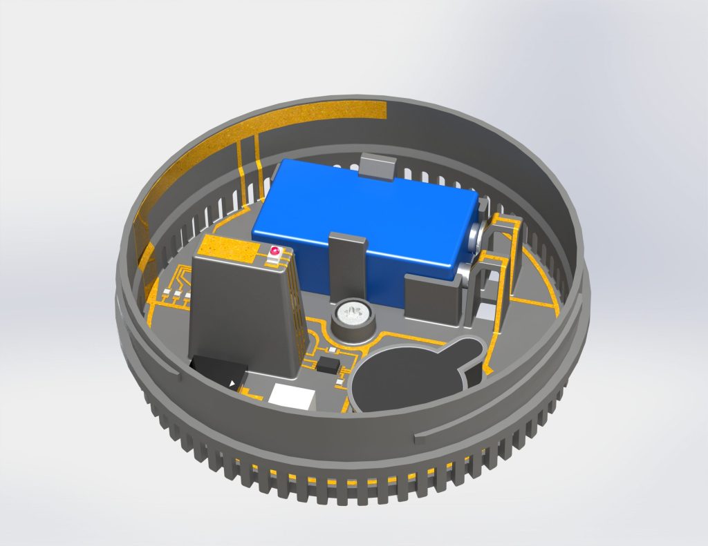

Today’s smoke detectors are ideally suited for upgrading to MID technology. The carrier material for smoke detectors today is made up of plastic components and provides a molded part to which the components may be fixed.
MID technology enables significant simplification of the design and the functional integration associated with the smoke detector. The battery holder is integrated directly in the MID part, thus forming all the metal contacts. The two connecting cables and the elaborate soldering process for bonding are now redundant. Standard SMDs can be soldered directly to the plastic, thereby saving costs while also allowing placement to be performed using pick-and-place machines, reducing personnel expenses for the assembly process to a minimum. The number of components is also reduced to a minimum – the printed circuit board is no longer required and circuit paths inscribed directly on the plastic replace the wires, which means that connecting plugs are also not needed.
Moreover, it is easy to integrate antennas in order to network the smoke detectors. By adapting the laser programming, any antenna structure can be applied directly to the same carrier material. Last but not least, because the MID technology eliminates the need for mechanical switches, it is simple to metallize a capacitive surface and use it as a capacitive switch.
