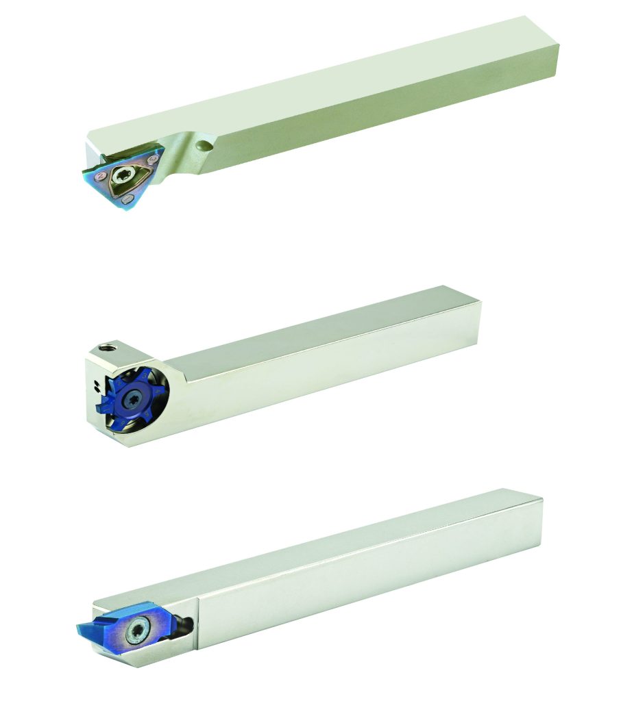

Carmex Precision Tools Ltd. has made four additions to its family of tools for Swiss-style machining applications, including the multifunction G6 six-edge turning insert designed to fit a single holder and capable of high productivity in applications, including threading, grooving, parting, and back and front turning.
The Swiss-Line inserts and toolholders, designed for parting, grooving, profiling and chamfering in mass production operations, feature PVD triple coating for high wear and heat resistance. The Swiss-Line polygon, for turning, back turning, parting, grooving, full-radius grooving and threading allows multiple inserts to be used with the same
toolholder.
The company's selection of specialized inserts for thread turning—UN or UNJ—can be used for internal or external threading. Manufactured of high-grade carbide, the inserts are multicoated for maximum performance. They include BMA-general purpose inserts, BLU-for use with Ti and stainless steel, and HBA-for hardened materials and super alloys.
According to Jim White, national sales manager for Carmex USA, “Carmex is answering the increasing demand for Swiss-type tooling by providing tools that combine high precision with flexibility. Our coated inserts have been specially developed for maximum performance in specific applications and deliver both improved surface quality and longer life. We look forward to introducing more shops and OEMs to these unique tooling configurations and quality inserts at significant savings.”
