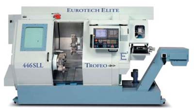

Eurotech Elite's new Trofeo series offers a design that delivers efficient and fast production of complex components, using live tools, C-axis and Y-axis. This high precision turn/mill center has up to 11-axes with dual turret and dual spindle. The Trofeo series provides up to 192 cutting tools for machining complex, precise parts and up to 48 live tools for milling operations. A redesigned layout eliminates "chip shelfs" found on most dual turret machines, according to the company. The machine was designed from the ground up for speed with gap elimination, Eurotech's tooling system (EGS), indexing on the fly, elimination of dwell times, fast pick-off speeds, zero wait for C-axis engagement on live tool machines, ClearShift 2-axis programmable subspindle to eliminate interference and decrease cycle times, programmable 2-axis servodriven parts gantry and conveyor system, built-in/no add-on automation. More than $60,000 in options plus many productive machine features are included, such as 2-axis Programmable automatic parts-catcher for main and subspindles (no changeover) and Fanuc 31i-T Series three channel control.
