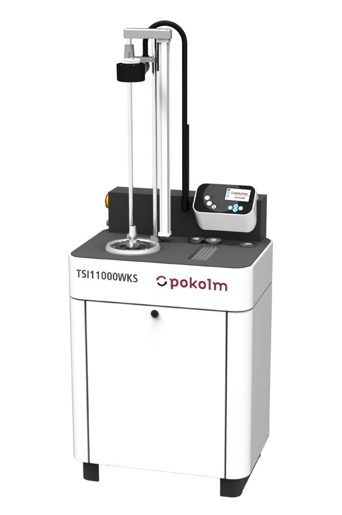

TSI11000WKS Induction Shrinking Station
The induction shrinking station line-up from Pokolm Frästechnik has been expanded with the fully automatic station TSI11000WKS. The coil and arbor of the new stand-alone station move fully automatically thanks to a pneumatic drive. The 50-litre coolant tank ensures fast cooling of both the arbor and the cooling medium.
June 26, 2017
The induction shrinking station line-up from Pokolm Frästechnik has been expanded with the fully automatic station TSI11000WKS. The coil and arbor of the new stand-alone station move fully automatically thanks to a pneumatic drive. The 50-litre coolant tank ensures fast cooling of both the arbor and the cooling medium. The arbor is additionally blown dry with compressed air after the cooling process.
The intuitive operating concept with predefined parameters for Pokolm shrinking arbors now includes also a color display for simple and language-independent control on the basis of pictograms.
The semiautomatic table-top device TSI11000WKT also benefits from the added functionality of the colour display with immediate effect.
Both comfort stations permit the saving of user-defined shrinking programs, and Pokolm reports that even data exchange via PC is no problem when using an optional accessory kit.
