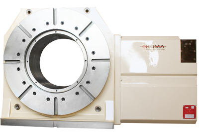

KOMA Precision Inc. introduces a new improved line of extra-large center bore, dual disc hydraulic clamping rotary tables from Tsudakoma. Like all Tsudakoma rotary tables, RCB Series has the proprietary dual lead worm gear system with ultra-precision cross roller bearings. The Tsudakoma dual lead gearing system delivers the optimal balance between power, durability and smooth cutting performance.
Three new models are available, with table diameter of RCB-350, R being 8.45″, RCB-450, R with 10.4″ and RCB-550, R with 12.4″. The RCB Series rotary tables can be mounted either vertically or horizontally. Various options such as chucks, tailstocks, support spindles, and faceplates are available. Pneumatic and Hydraulic rotary joints for automatic load and unload of the work piece are also available.
