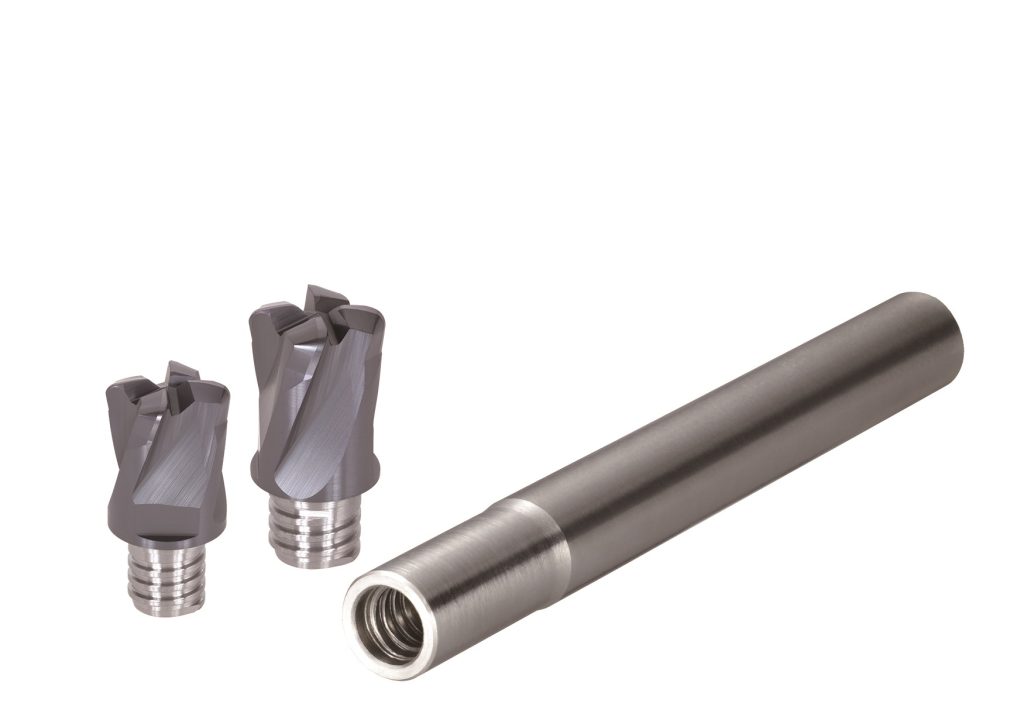

Tungaloy expands its TungMeister series of interchangeable milling head system, to include 4-flute cutter heads with high-feed capability.
May 2, 2019
The interchangeable TungMeister heads allow a quick, easy, and accurate tool change between various operations. Now the system incorporates a 4-flute option of the VFX-4 style cutting heads for elevated feed capability.
High-feed milling technique is common for many manufacturers who are seeking efficient metal removal. To meet the increasing market demands for higher milling efficiency, TungMeister now offers a 4-flute high feed head in addition to the existing 2-flute head. An increased flute count allows higher parameters, as well as prolonged tool life because the same working load is produced by having more cutting edges engaged in the cut. Soft cutting and strong geometry also improve tool life and stability thanks to its helical cutting edge and larger tool core.
At a Glance:
4-flute cutting head for high feed provides milling efficiency
Extended tool life
Helical cutting edge for light cutting
Total of 2 interchangeable heads are added
