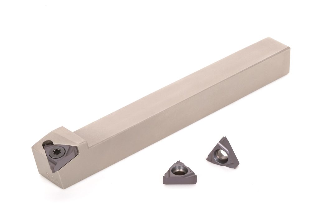

Tungaloy expands its TungThread line of indexable threading tools to include 11ER external threading inserts, as well as 8×8 mm and 10×10 mm square shank holders to accommodate the new inserts.
These new 11ER threading inserts and two square shank holders are specifically designed with users of Swiss-type automatic lathes in mind. The 11ER insert is smaller than conventional 16ER inserts, and the insert holders are designed to ensure a minimum interference when machined towards the sub-spindle, which is an issue with a 16ER insert holder.
This expansion will enhance the TungThread series to meet the needs of various threading applications on Swiss type automatic lathes and other small-parts manufacturing equipment.
At a glance:
Small 11ER threading inserts – ideal for the use on small-parts manufacturing machines
8×8 mm and 10×10 mm square shank holders for Swiss lathes
Thread types are available for ISO metric threads of 0.35 to 1.5 mm thread pitches, as well as V-profile 60° and 55°, partial profile
Two holders and 10 inserts to be added in this expansion
