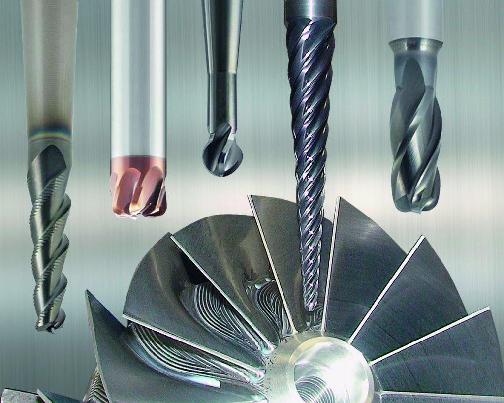

Emuge Corp. has introduced an advanced line of endmills featuring unique geometry designed specifically for the high-performance machining of turbine and bladed components. New Emuge Turbine End Mills offer unprecedented cycle time reductions and long tool life in challenging forms and materials, including titanium, nickel alloys, aluminum alloys and more.
Complex shapes including wide sweeping radii and deep pocketed cavities present ample challenges for aerospace and turbine manufacturers. "We are very pleased to offer our customers a solution to meet the unique requirements for milling turbine parts, as well as for the die and mold industry, " said Dan Doiron, milling product manager, Emuge Corp. Mold applications include machining tire molds and plastic injection molds, among others.
Suitable for machining components with challenging geometries, new Emuge Turbine End Mills have a stable design including on the tools featuring a tapered flute construction. The endmills feature PVD-applied, highly hard and heat-resistant coatings, and a newly developed geometry that enables aluminum machining.
The Emuge Turbine End Mills Line includes a wide range of taper ball tools that feature a submicrograin carbide substrate and an HA cylindrical shank. The 3°, 4°, 6° and 8° taper ball tools have 2- and 3-flute designs, and the 17.5° has 3 flutes. Polished flutes in the 3°, 4°, 6° and 8° tools promote chip evacuation in aluminum alloys. Coating options for the taper -all tools include AlCR for additional tool life in titanium alloys, high-temperature alloys, stainless steel and aluminum alloys, and TiAlN for heat and abrasion resistance in a wide range of materials such as stainless steel, steel alloys, cast iron and other ferrous metals.
Taper Torus endmills include 3°, 4°, 6° and 8° sizes featuring 2 highly polished flutes, submicrograin carbide, and have a torus "cupped" radius end design for maximum step-over lengths. AlCR coating is standard, and TiAlN coatings are available.
A long 8° taper torus style also features a torus cupped radius. The cutting flutes are tapered for increased efficiency in a range of designs from 5 to 15 flutes. The tools are TiAlN coated for maximum tool life and include axial coolant through capability.
The Emuge Turbine End Mills Line includes a torus long-length tool style, which features variable flute spacing for low-vibration milling. The tools are available in designs ranging from 5 to 9 flutes and have a corner radii of 1.0 or 2.0 mm. Torus long length endmills are TiAlN-coated for maximum tool life and include coolant-through capability.
