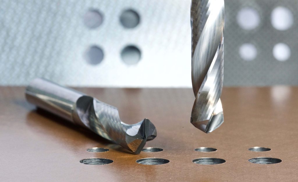

LACH DIAMOND says its newly developed PCD twist drill type PS saves up to 75 percent of time by reducing three previously necessary steps to one process. The new PCD twist drill completes piloting, drilling and reaming all in one "shot."
May 30, 2017
LACH DIAMOND says its newly developed PCD twist drill type PS saves up to 75 percent of time by reducing three previously necessary steps to one process. The new PCD twist drill completes piloting, drilling and reaming all in one “shot.”
LACH DIAMOND looks back on a long tradition of developing and manufacturing PCD drills for the machining of composites – CFRP – GRP – especially for use in aircraft and automotive lightweight construction.
LACH DIAMOND PCD twist drills have a 70° to 180° point angle and are available with either a double-cone or step-drill geometry and a double margin for drilling qualities up to h6. Standard drills are available from 2.5 to 12 mm in diameter.
