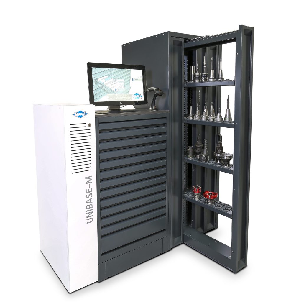

If large, heavy tools are already assembled in the production area but are not yet needed on the machines, they should be stored away. Cabinet drawers with a maximum load-bearing capacity of 75 kg are not ideally suited for this. They often reach their limits when loaded with several completely assembled tools. Sometimes, on account of its length, the tool can only be stored horizontally and this presents a risk to the cutting edges. It's with situations like these in mind that MAPAL has introduced the new UNIBASE-V expandable cabinet with up to four electronically lockable vertical drawers. Each of the automatically opening drawers has a maximum load-bearing capacity of 600 kg and is equipped with loadable tool holders designed according to the customer's specifications. The vertical drawers are compatible with existing UNIBASE-M systems and are controlled via the master unit.
The new UNIBASE-C cabinets for controlled individual tool dispensing complete the storage module. A large number of small and single parts can be stored in a UNIBASE-C cabinet in a relatively small area. When an item is selected only its individual compartment opens, helping reduce risk of theft. UNIBASE-C is available in standard versions. It can be used as a stand-alone solution or can be incorporated into existing UNIBASE-M systems.
