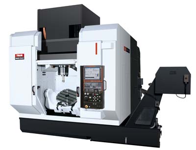

Mazak's high-performance VARIAXIS 730-5X II provides high-speed, heavy-duty, five-axis machining of large, complex parts.
April 1, 2010
Mazak’s high-performance VARIAXIS 730-5X II provides high-speed, heavy-duty, five-axis machining of large, complex parts. The machine is equipped with a 30-tool magazine standard or 80-tool or 120-tool optional magazines. The machine’s 50-taper spindle features high-performance characteristics, including a maximum spindle speed of 10,000 rpm and 40 hp. The 1,654-ipm rapid traverse rate in X-, Y- and Z-axes reduces cycle times. Additionally, the machine’s tilting rotary table has an A-axis (tilting) rotation of 150 degrees and a C-axis rotation of +/- 360 degrees, both in increments as small as 0.0001 degrees. Machine travels are 28.74″ x 33.46″ x 22.05″ on the X, Y and Z axes, respectively. The table size on a single-pallet machine is 24.8″ x 19.7″, with a maximum table load of 1,102 lbs. An optional two-pallet changer system features a table of 19.7″ x 19.7″. With the two-pallet option, the VARIAXIS 730-5X II can easily be expanded to include Mazak’s Palletech material handling technology to increase spindle utilization dramatically through unattended operation.
