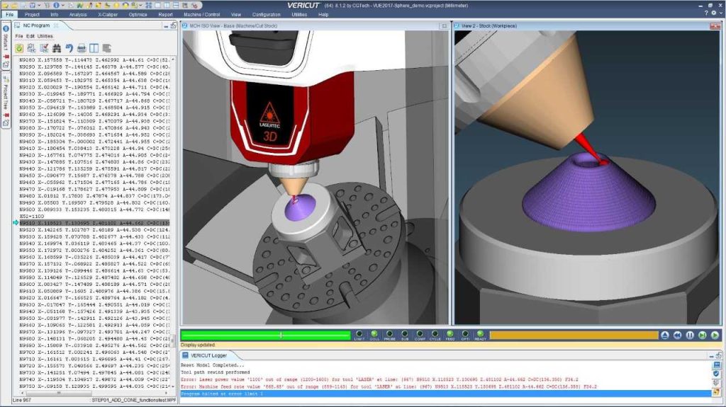

Additive material deposition can now be seen in VERICUT's Reviewer and NC Program Review. Additive errors and red error color are applied to deposited material when any of the additive functions being checked are not compliant, making it easy to spot potential problems in additive processes. A single click identifies the error source.
Users can optimize more complex NC programs, including looping, branching, IF/THEN, and DO-WHILE code, while retaining all decision-making logic. Optimized NC programs and subroutines are ready to run with no edits by the user. Force Charts that graphically document the cutting process are enhanced with higher fidelity, so they can display even tiny material volumes and forces encountered.
