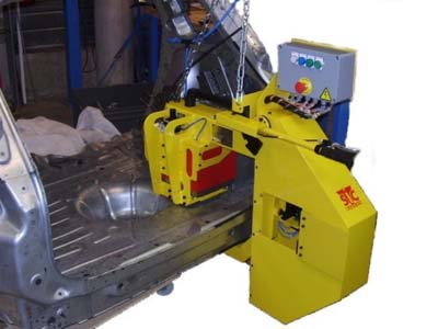

Key Features:
  • The extremely fast scribing i113s unit is capable of 17 characters in less than 20 seconds, with 0.3mm depth.
  • The system utilizes the E8 controller known for its robustness and versatility with more than 15 languages available.
  • Specialist SIC VIN software has been written for VIN marking applications.
In addition, a “reading” option allows validation of the mark through a camera. It analyzes its shape and its content. The software can be customized and the marking head can be supplied with bespoke fixturing. Communication protocols include (I/O, RS232, Profibus, Ethernet, Jbus, Profinet). The versatility, robust construction, proven reliability and ease of integration has already convinced some of the largest automotive manufacturers in the world, in Korea (Renault Samsung), Russia (Peugeot, Mitsubishi, AVTO FRAMOS, AVTO FAZ) and Morocco (Dacia).
