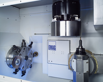

A customizable machine, as the "C" in the name indicates, the VLC 800 vertical turning center can be configured for a wide range of applications. Combining multiple modules to choose from and the time-tested EMAG modular design means that the VLC's machining area can be configured for a wide range of machining tasks. For example, the machine can be fitted with two tool turrets equipped with driven tools and, as an option, can travel on an additional X-axis. Furthermore, drilling and milling spindles with tool magazines can be mounted on a Y-B-axis unit. As a result of the machines' high strength and precision, they can also tackle grinding and hard machining. The VLC 800 can be used for almost any type of machining on large workpieces.
The sturdy main spindle with a drive rating of up to 74 kW, 4400 Nm of torque and speeds up to 500 rpm ensures that machining processes are completed quickly. The Mineralit polymer concrete machine base is made using a cold casting process for particularly good vibration damping, which in turn minimizes tool wear and delivers excellent surface quality. The spindle motor, main spindle, tool turret, electrical cabinet and machine body are liquid-cooled. A dual-circuit cooling unit readjusts the machine temperature to the ambient temperature within close tolerances. Consequently, VLC turning centers produce even large components with accuracies in the range of a hundredth of a millimeter. For optimal quality control, however, an optional probe can be installed outside the machining area to verify dimensions. Not only is the probe protected from chips, but the measurement is carried out just before the loading or unloading process, saving time.
Naturally, the VLC 800 also features the typical EMAG pick-up system consisting of an included parts storage facility and pick-up spindle. Raw parts are placed on the integrated conveyor belt for transport in and out of the machine either by hand or using additional automation components. The spindle picks up the workpiece from the conveyor and guides it to the various stations in the machining area. The short distances from the conveyor belt to the machining areas and back minimize the chip-to-chip times and ensure excellent efficiency. The integrated automation system also simplifies the structure of production lines since there is no need for complicated automation systems to load the machines. All that is required is a part transport system between the conveyor belts, easily achievable with simple automation components such as additional conveyors, pick-and-place units or changers. Using as few components as feasible also reduces possible fault sources.
