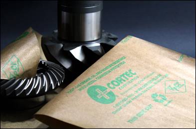

Cortec® VpCI®-148 is a protective packaging paper for ferrous and non-ferrous metals. It provides corrosion protection on one side and excellent resistance to grease, oil, and solvents on the other. It is available in custom sizes wider than the industry average to accommodate large parts. Furthermore, it offers a degree of natural cushioning not found in standard VCI plastic.
VpCI®-148 Paper also presents positive environmental aspects and a worker friendly profile. As paper, it is sourced from renewable materials, whereas common VCI plastics are sourced from fossil fuels. Furthermore, it uses a water-based coating for grease resistance, rather than the wax or poly coatings typically used for barrier papers. VpCI®-148 Paper is non-hazardous and free of fluorochemicals, nitrites, phosphates, silicones, chromates, and other heavy metals.
Because of its oil and grease resistance, VpCI®-148 Paper is ideal for protecting bearings and other metal parts that require lubrication or cannot be cleaned from residual process oils before packaging. VpCI®-148 protects against humidity, SO2, H2S, and galvanic corrosion from dissimilar metals. Possible uses include single item packaging, as well as interleaving, lining, or separating multiple metal parts in the following sectors:
