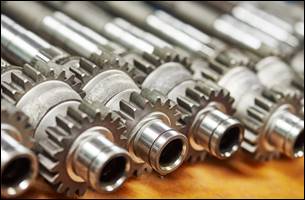

There are many possible applications where VpCI®-330 can be used as an all-purpose rust preventative. Some good examples include (but are by no means limited to) the following:
  • Gears
  • Spindles
  • Coils
  • Hinges
  • Flanges
  • Nuts and Bolts
