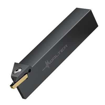

Walter USA LLC has expanded its line of Walter Cut tools for parting, grooving and turning with three new models optimized for shallow depth grooving of up to a maximum of 0.236" (6mm).
February 12, 2012
Walter USA LLC has expanded its line of Walter Cut tools for parting, grooving and turning with three new models optimized for shallow depth grooving of up to a maximum of 0.236″ (6mm).
These three new tools, designated G1511, G1521 and G1551, each have different approach angles. The G1511 is straight 0 degrees, the G1521 is angled at 90 degrees, and the G1551 is angled at 45 degrees. The straight and the 90 degree versions are suitable for radial and axial face grooving, as well as for turning. The 45 degree G1551 is primarily intended for recesses, undercutting and copy turning applications.
Though optimized for shallow grooving, all three models can be used for a variety of applications including parting off small and thin-walled workpieces or for making sealing ring and snap ring grooves. This reduces the number of tools required and leads to a reduction in tool and inventory costs. These double-edged inserts are formed from the latest Tiger-tec cutting tool materials with geometries and coatings specifically for grooving.
As with previous tools in the Walter Cut G1011 range, the three new models boast a key feature that both simplifies handling and increases safety: The clamping screw can be accessed from both sides. This means that inserts can be changed quickly and easily, even with inverted use. In addition, the low tool height typical of Walter Cut toolholders facilitates chip removal, thereby enhancing process reliability.
